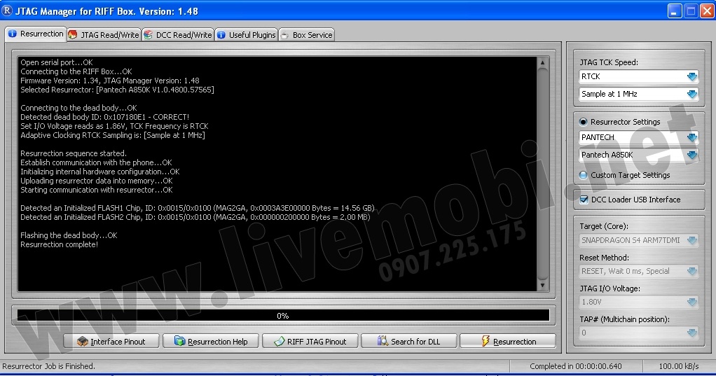

    Unlock - repair boot all phone
    HCM city
    Repair SKY IM-A850 Dead boot OK.
