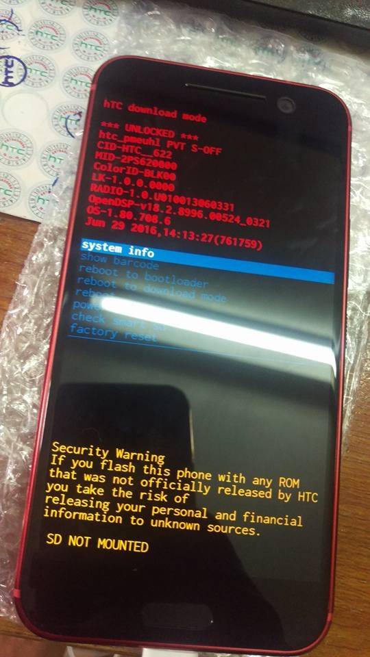

Chia sẻ Htc 10 (htc_pmeuhl) s-off + supercid, firmware, rom tiếng việt

    HTC 10 (htc_pmeuhl) s-off + superCID, Firmware, Rom Tiếng Việt

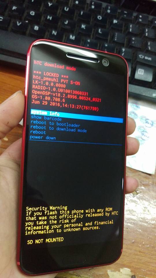

    E:\adb_thuanmobile896>fastboot getvar all
    INFOkernel: lk
    INFOproduct: htc_pmeuhl
    INFOversion: 1.0
    INFOimei: 354261---
    INFOversion-main: 1.80.708.6
    INFOboot-mode: download
    INFOversion-baseband: 1.0.U010013@60331
    INFOversion-bootloader: 1.0.0.0000
    INFOmid: 2PS620000
    INFOcid: HTC__622
    all:
    E:\adb_thuanmobile896>fastboot oem get_identifier_token
    ... INFO[KillSwitch] : /dev/block/bootdevice/by-name/frp
    INFO[KillSwitch] Last Byte is 0X00, disable unlock
    INFO[KillSwitch] oem unlock Turn Off!
    OKAY

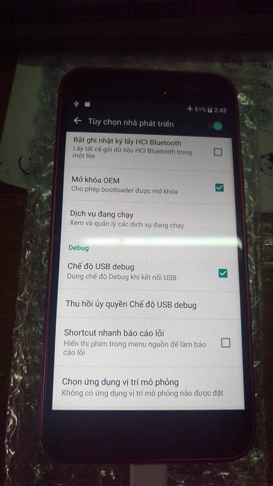

    Menu -> Developer settings, and tick "Enable OEM unlock"
    INFO[KillSwitch] Last Byte is 0X01, enable unlock
    INFO
    INFO< Please cut following message >
    INFO<<<< Identifier Token Start >>>>
    INFO2A8B8E3E4EA8E3C5FAE3CBBFE046E275
    INFO20FC099D066B081B51CA101924D3B8AB
    INFOA1CAEAC0DA3A02770311B7F6D47189AF
    INFO4CCEDBB8A31ECFC6325CD002072813B7
    INFO9B193AD92ED8AE69D4C531B9F609ADA2
    INFO9B60DFEE1983DC482BAE512682AE9F31
    INFO5249035025912DCC87D2E14F0177C8FA
    INFO05D07FD5E1B3E69456E767DD73641951
    INFOB21FD95625BD4185CD5288DD08551574
    INFOECE1F551D083550A9B55DAB2C3EC0E15
    INFO98568598E912451571489BBB4CB0A3E5
    INFOC1F840F7060BD2919D9F8B7A96F1BD3A
    INFOBFA850C3211CD6FDE81ECB824DA9E93A
    INFO386405ED78EB78ED08FCB294D1E5A79C
    INFO8CE85BF0AE38BE71D43D4BC0AC459D25
    INFOA6372B2F035B1E813DF7511ECF216997
    INFO<<<<< Identifier Token End >>>>>
    OKAY
    E:\adb_thuanmobile896>fastboot flash unlocktoken unlocktoken_FA66DBN00174.bin
    sending 'unlocktoken' (0 KB)... OKAY
    writing 'unlocktoken'... INFOflash unlocktoken
    FAILED (remote: UnlockToken Verify Fail!!)
