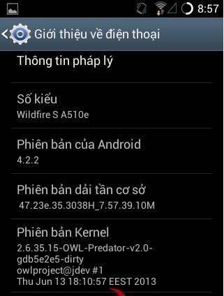

    HTC Wildfire S (A510e) Unlockbootloader + Rom 4.2.2 Tiếng Việt ok

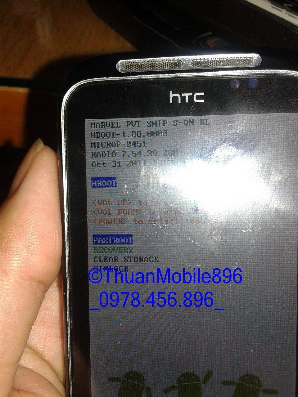

    product: marvel
    modelid: PG7610000

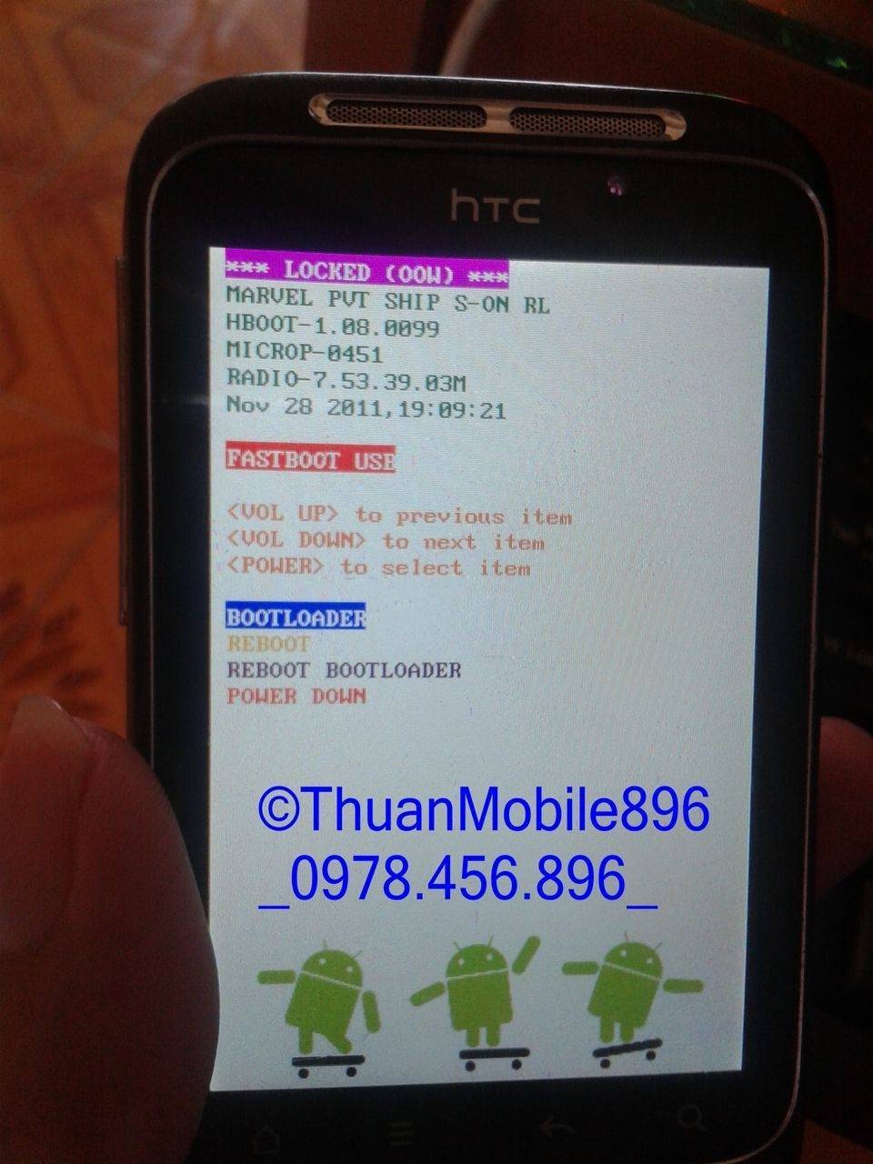

    version-bootloader: 1.08.0000 -> Không có chữ ***LOCKED***
    flash file hboot_1.08.0099__locked.zip --> có chữ LOCKED ok

    C:\Documents and Settings\Admin\Desktop\adbbb>fastboot getvar all
    < waiting for device >
    INFOversion: 0.5
    INFOversion-bootloader: 1.08.0000
    INFOversion-baseband: 7.54.39.28M
    INFOversion-cpld: None
    INFOversion-microp: 0451
    INFOversion-main: 2.13.401.3
    INFOserialno: SH236TR01164
    INFOimei: 358968--9604
    INFOproduct: marvel
    INFOplatform: HBOOT-7227
    INFOmodelid: PG7610000
    INFOcidnum: HTC__Y13
    INFObattery-status: good
    INFObattery-voltage: 3830mV
    INFOpartition-layout: HTC
    INFOsecurity: on
    INFObuild-mode: SHIP
    INFOboot-mode: FASTBOOT
    INFOcommitno-bootloader: f2c4562e
    INFOhbootpreupdate: 12
    INFOgencheckpt: 0
    all: Done!

    C:\Documents and Settings\Admin\Desktop\adbbb>fastboot oem rebootRUU
    ... OKAY
    C:\Documents and Settings\Admin\Desktop\adbbb>fastboot flash HTC_Marvel_PG7610000__hboot_1.08.0099__locked.zip
    sending 'zip' (10338 KB)... OKAY
    writing 'zip'... INFOadopting the signature contained in this image...
    INFOsignature checking...
    INFOzip header checking...
    INFOzip info parsing...
    INFOchecking model ID...
    INFOchecking custom ID...
    INFOchecking main version...
    INFOstart image[hboot] unzipping for pre-update check...
    INFOstart image[hboot] unzipping & flushing...
    INFO[RUU]UZ,hboot,0
    INFO[RUU]UZ,hboot,100
    INFO[RUU]WP,hboot,0
    INFO[RUU]WP,hboot,100
    INFOstart image[radio] unzipping & flushing...
    INFO[RUU]UZ,radio,0
    INFO[RUU]UZ,radio,8
    INFO[RUU]UZ,radio,17
    INFO[RUU]UZ,radio,25
    INFO[RUU]UZ,radio,34
    INFO[RUU]UZ,radio,42
    INFO[RUU]UZ,radio,47
    INFO[RUU]UZ,radio,55
    INFO[RUU]UZ,radio,64
    INFO[RUU]UZ,radio,72
    INFO[RUU]UZ,radio,77
    INFO[RUU]UZ,radio,85
    INFO[RUU]UZ,radio,94
    INFO[RUU]UZ,radio,100
    INFO[RUU]WP,radio,0
    INFO[RUU]WP,radio,6
    INFO[RUU]WP,radio,11
    INFO[RUU]WP,radio,20
    INFO[RUU]WP,radio,28
    INFO[RUU]WP,radio,33
    INFO[RUU]WP,radio,42
    INFO[RUU]WP,radio,53
    INFO[RUU]WP,radio,62
    INFO[RUU]WP,radio,100
    OKAY
    C:\Documents and Settings\Admin\Desktop\adbbb>fastboot reboot-bootloader
    rebooting into bootloader... OKAY
    INFOversion: 0.5
    INFOversion-bootloader: 1.08.0099
    INFOversion-baseband: 7.53.39.03M
    INFOversion-main: 2.17.0.0
    INFOimei: 358968--89604
    INFOproduct: marvel
    INFObattery-voltage: 3888mV
    INFOsecurity: on
    INFOcommitno-bootloader: 6e20b6fa
    INFOgencheckpt: 0
    all: Done!
