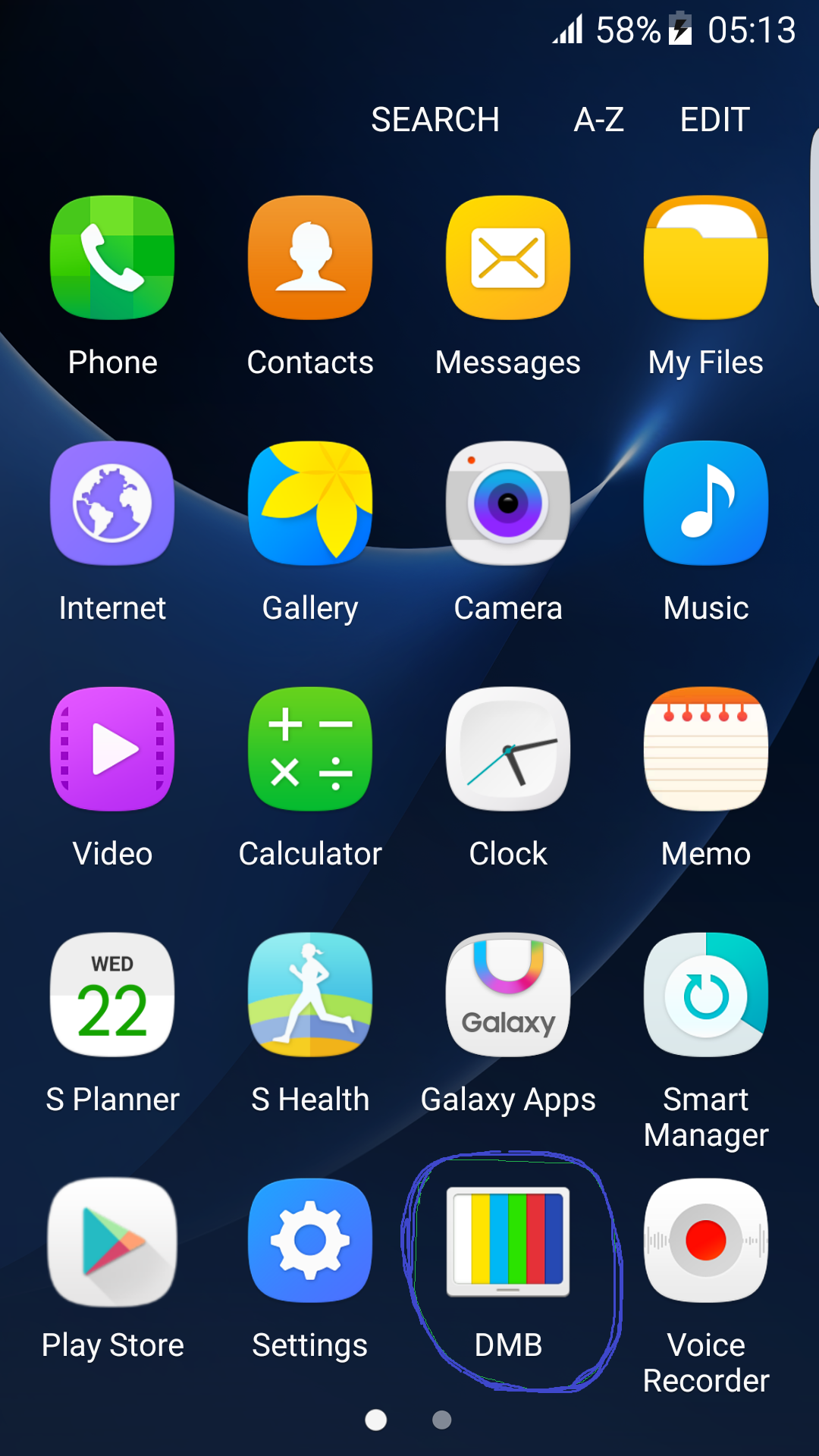

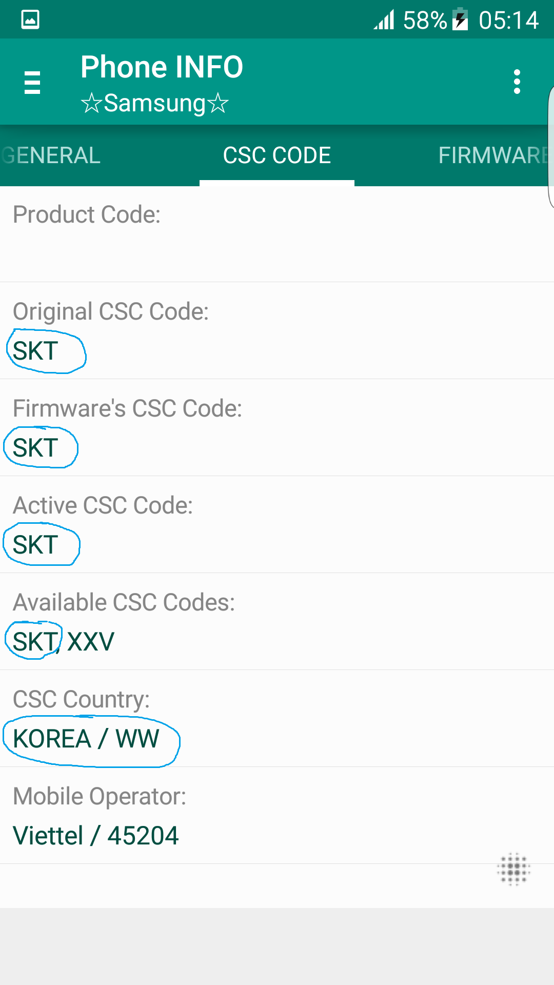

  11. LT87
    LT87 Well-Known Member
    Mar 9, 2015
    648
    1,408
    Flash ROM is complete, reboot the system now, and then flash skt_csc. Not flash rom and simultneaously skt_csc

  13. LT87
    Mar 9, 2015
    648
    1,408
    #2213 LT87, Jun 22, 2016
    * / I checked again, it totally worked:
    * / You follow these steps:
    Flash ROM / install option fragrance ..> reboot> to upload settings screen> Full installation is complete on the custom recovery:
    - Wipe cache
    - Wipe Dalvik / ART cache
    - Flash SKT_csc + DMB apps
    - Factory Reset
    - Wipe cache
    - Wipe Dalvik / ART Cache
    - Restart> Enjoy
    */There are so many Koreans have made their success and thanked me via email
