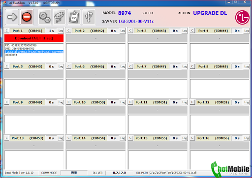

    18:32:28 : ******Extract Start C:\Users\CRSERVICE\Downloads\F320K11K_00.kdz*****
    18:32:28 : Model Dll Dir(C:\ProgramData\LGMOBILEAX\Phone\)
    18:32:28 : Check 2G-4G big size kdz file..
    18:32:28 : Extract 2G-4G big size kdz file..
    18:32:28 : NNNNN WDB FullPath(C:\Users\CRSERVICE\Downloads\F320K11K_00.kdz)
    18:32:28 : NNNNN Model dll FullPath(C:\ProgramData\LGMOBILEAX\Phone\LGUP_8974.dll)
    18:32:28 : Extract End C:\Users\CRSERVICE\Downloads\F320K11K_00.kdz
    18:32:28 : 01 Skip delete kdz 1.1 file...
    18:32:28 : ------------------Model.dll Information-------------------
    18:32:28 : Filename : LGUP_8974.dll
    18:32:28 : Version : 0.2.12.0
    18:32:28 : File size : 1466880
    18:32:28 : File date : 2013/12/26-18:32:28
    18:32:28 : PC Created date: 2013/12/26-18:32:28
    thay build.prop thành s/l/k up flashtooh mà nó flash nghe vèo vèo nè:D

    tùng format cả system vẫn có thể cứu soft brick thành công bằng UpTestEX.exe Bác nào bản L liên hệ tùng test thử nha:D
