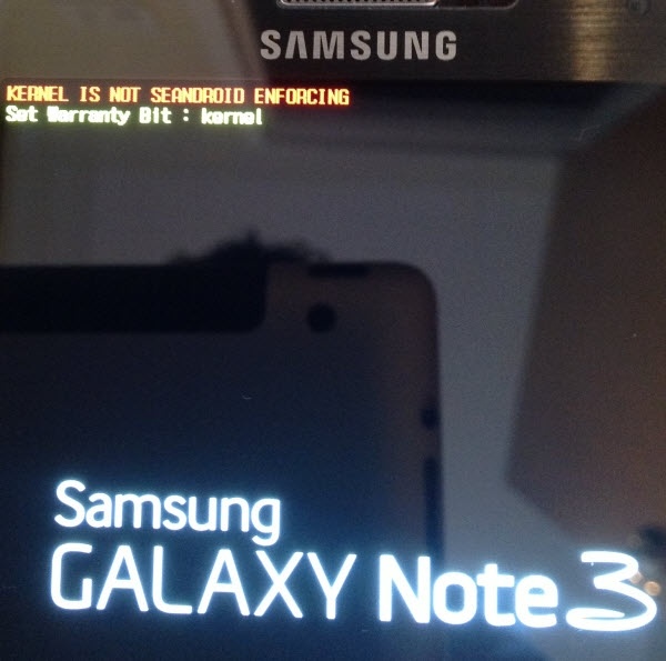

    loi nay lam sao khac phuc duoc vay anh

    Xài kernel cook. Haha

    dung kernel tren cua bac Manh_IT do anh
    anh co cai kernel nao khong bi loi khong
