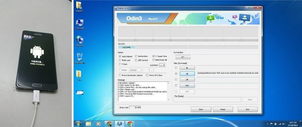

    I used this ROM and enjoyed it until decided upgrade to "SphinX-v2a-Lollipop(BOH3)_BETA4" .
    in flash processing crash with this error :
    <ID:0/007> Added!!
    <OSM> Enter CS for MD5..
    <OSM> Check MD5.. Do not unplug the cable..
    <OSM> Please wait..
    <OSM> Note-Edge-SCL24_SphinX-v2a-Lollipop(BOH3)_BETA4.tar.md5 is valid.
    <OSM> Checking MD5 finished Sucessfully..
    <OSM> Leave CS..
    <ID:0/007> Odin engine v(ID:3.1005)..
    <ID:0/007> File analysis..
    <ID:0/007> SetupConnection..
    <ID:0/007> Initialzation..
    <ID:0/007> Get PIT for mapping..
    <ID:0/007> Firmware update start..
    <ID:0/007> SingleDownload.
    <ID:0/007> aboot.mbn
    <ID:0/007> NAND Write Start!!
    <ID:0/007> boot.img
    <ID:0/007> cache.img.ext4
    <ID:0/007> hidden.img.ext4
    <ID:0/007> FAIL! (Auth)
    <ID:0/007>
    <ID:0/007> Complete(Write) operation failed.
    <OSM> All threads completed. (succeed 0 / failed 1)
    <ID:0/007> Removed!!
    and i force to back "SCL24KDU1BOH3" stock LOCK ROM.
    then when i want flash this rom error happened agan.
    please help me with English langues .
    Thanks

    The Problem was Solved
    Go to Settings -> Security then uncheck ReActivelock.
