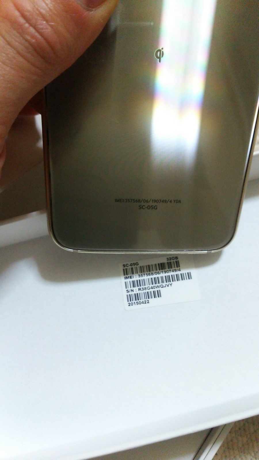

    may minh mua cua nha mang, co hop va bao hanh, lam sao ma hang luoc duoc ban. minh cung khong biet vi sao ma lai bi nhu vay. de chieu di lam ve minh up hinh len moi nguoi xem thu nhe.
  16. woodhead
    11/6/15
    19
    day ne ban, so s/n in tren hop luon

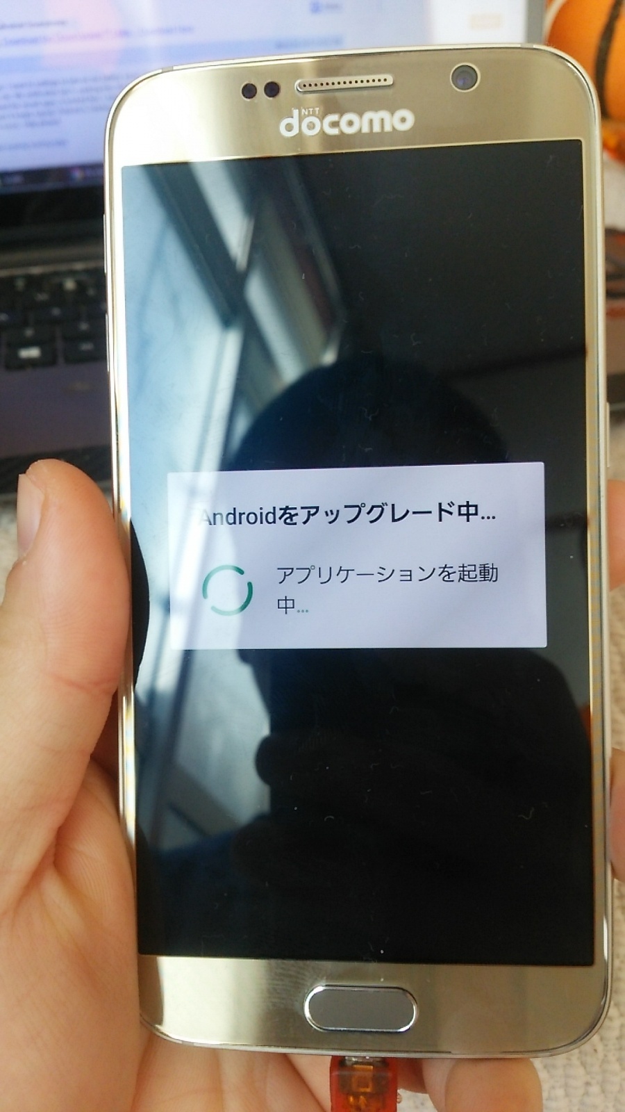

    cap nhat tinh hinh, minh vua nhan dc cai z3x box, down stock rom tu z3x team, flash lai thi van bi y nhu cu. len toi mang hinh android app upgrading,...starting apps....rui dung yen luon.khong chay dc nua.
    bac nao cao nhan co y kien gi ve con nay khong?
