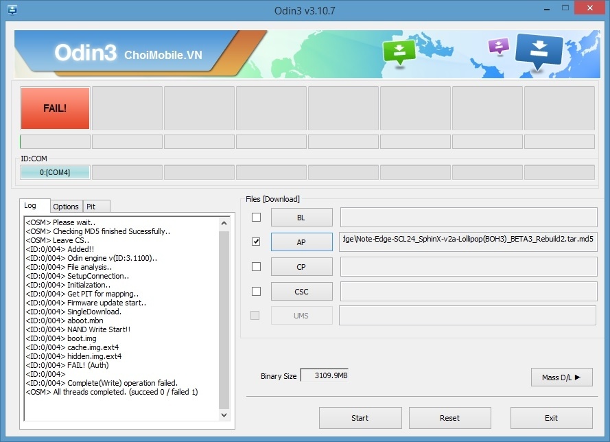

    Hi Guys
    I have this problem . when i want flash this ROM form KitKat , clash to this error.
    so i can't read your comment in Vietnamese Language .
    please help me with English Language.
    Thanks

  18. Godfather
    10/10/15
    Hi Guys
    I decided upgrade to "SphinX-v2a-Lollipop(BOH3)_BETA4" .
    in flash processing crash with this error :
    <ID:0/007> Added!!
    <OSM> Enter CS for MD5..
    <OSM> Check MD5.. Do not unplug the cable..
    <OSM> Please wait..
    <OSM> Note-Edge-SCL24_SphinX-v2a-Lollipop(BOH3)_BETA4.tar.md5 is valid.
    <OSM> Checking MD5 finished Sucessfully..
    <OSM> Leave CS..
    <ID:0/007> Odin engine v(ID:3.1005)..
    <ID:0/007> File analysis..
    <ID:0/007> SetupConnection..
    <ID:0/007> Initialzation..
    <ID:0/007> Get PIT for mapping..
    <ID:0/007> Firmware update start..
    <ID:0/007> SingleDownload.
    <ID:0/007> aboot.mbn
    <ID:0/007> NAND Write Start!!
    <ID:0/007> boot.img
    <ID:0/007> cache.img.ext4
    <ID:0/007> hidden.img.ext4
    <ID:0/007> FAIL! (Auth)
    <ID:0/007>
    <ID:0/007> Complete(Write) operation failed.
    <OSM> All threads completed. (succeed 0 / failed 1)
    <ID:0/007> Removed!!
    and i force to back "SCL24KDU1BOH3" stock LOCK ROM.
    then when i want flash this ROM or another, error happened again.
    please help me with English langues .
    Thanks
  19. thanhmi
    thanhmi Team SS
    15/2/13
    46
    30
    Setting -> Security then Uncheck ReActivelock.
